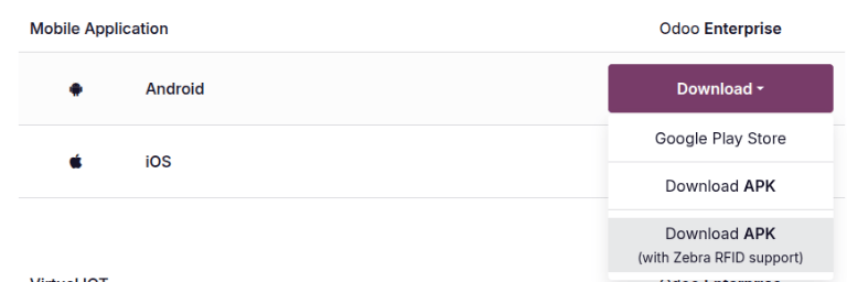

Then, download the APK. On the Downloads page, under the Mobile Application section, click Download next to the Android option, then select Download APK (with Zebra RFID support) from the drop-down menu. Download this file via a computer and transfer the APK via USB or Bluetooth, or use the device’s web browser to download the APK.
Download the APK from the Download page.
Install the APK. If Install unknown apps is enabled for the device’s web browser, install the APK directly from the browser download notification. If Install unknown apps is enabled for the device’s file manager, open it and navigate to the location where the file is stored, then tap it to install the APK.
