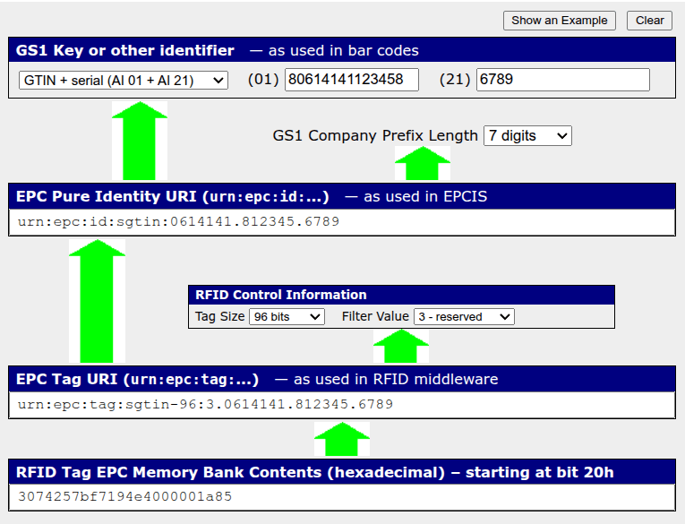

To retrieve an EPC to encode on a tag, use GS1’s EPC Encoder/Decoder tool.
  1. Enter the GTIN-14 barcode of the product in the application identifier (01) field.
  2. Enter the product’s serial number in the (21) field.
  3. Specify a company prefix length.
  4. Specify the size of the tag and its filter value.
Complete the fields of the EPC Encoder/Decoder tool.
